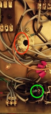

On the one foto with red circle, inside this circle i saw a short circuit during turning volume pot. One what i noticed is, when i moved the Brown cable from OT, this circuit and noisy "shhhh..." were off. Maybe this cable is somewhere broken down? Or one or both trafos?

By the way, in the first picture above, I was wondering is the resistor was soldered onto the jack; I added a green circle to show where.

This is line out jack and i soldered it onto the signal pin. Do you think IT could be a problem?

My question was: is there a weld (hard to see on the picture) ?
More generally, I find your welds (those on the picture) not loaded enough with solder (no offense :oops:). :think:

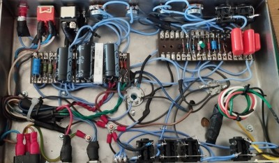

Can you send a picture at all the wiring ?

I can send, but i decided to make it once more, with new plate etc.

If you are rewiring, it would be advisable to use different colored cables as follows:
- earth in green-yellow
- brown and blue for mains
- ground in black (every ground and only ground)
- HV power in red (A+, B+, ...)
- 6.3V (heating) in green with the two wires twisted
- one (or more) color for anything else
This complicates the wiring a bit but provides valuable assistance when making modifications, upgrades or troubleshooting.
As you previously said, if it worked in the old case, there's no reason why it wouldn't work in the new one (except bad soldering or bad wiring :mrgreen:).
