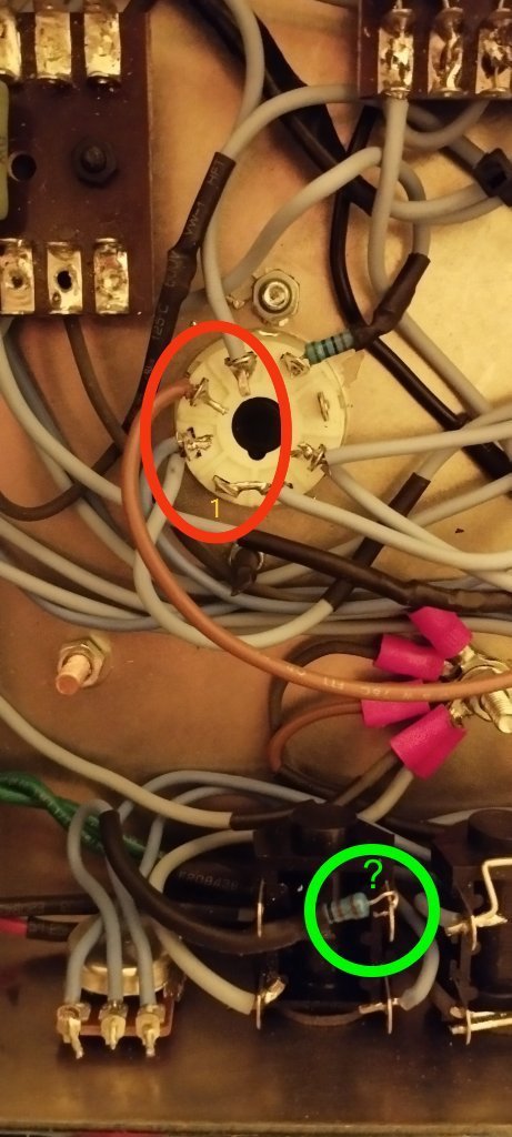

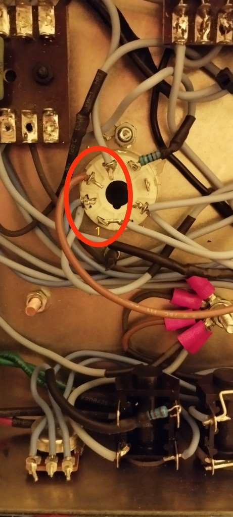

Good Evening, i worked with multimeter and i think i did IT well.
On the one foto with red circle, inside this circle i saw a short circuit during turning volume pot. One what i noticed is, when i moved the Brown cable from OT, this circuit and noisy "shhhh..." were off. Maybe this cable is somewhere broken down? Or one or both trafos?

Re: Problem with my G5 amp
Hi Papa_Mateo,
Checking every solder is a good idea.
By the way, in the first picture above, I was wondering is the resistor was soldered onto the jack; I added a green circle to show where. Good luck (and be patient) !

Good Today,
This is line out jack and i soldered it onto the signal pin. Do you think IT could be a problem?
I decided to check everything once more. I will save much more time.
Thank you very much
Thank you very much
My question was: is there a weld (hard to see on the picture) ?
More generally, I find your welds (those on the picture) not loaded enough with solder (no offense

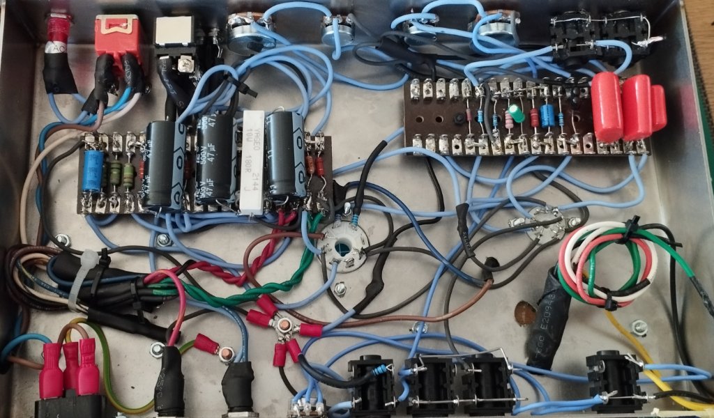

Can you send a picture at all the wiring ?
Papa_Mateo
- Messages : 19
- Enregistré le : 06 mars 2024, 23:09
I can send, but i decided to make it once more, with new plate etc.
If you are rewiring, it would be advisable to use different colored cables as follows:
- earth in green-yellow
- brown and blue for mains
- ground in black (every ground and only ground)
- HV power in red (A+, B+, ...)
- 6.3V (heating) in green with the two wires twisted
- one (or more) color for anything else
This complicates the wiring a bit but provides valuable assistance when making modifications, upgrades or troubleshooting.
As you previously said, if it worked in the old case, there's no reason why it wouldn't work in the new one (except bad soldering or bad wiring
