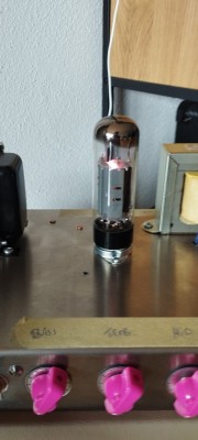

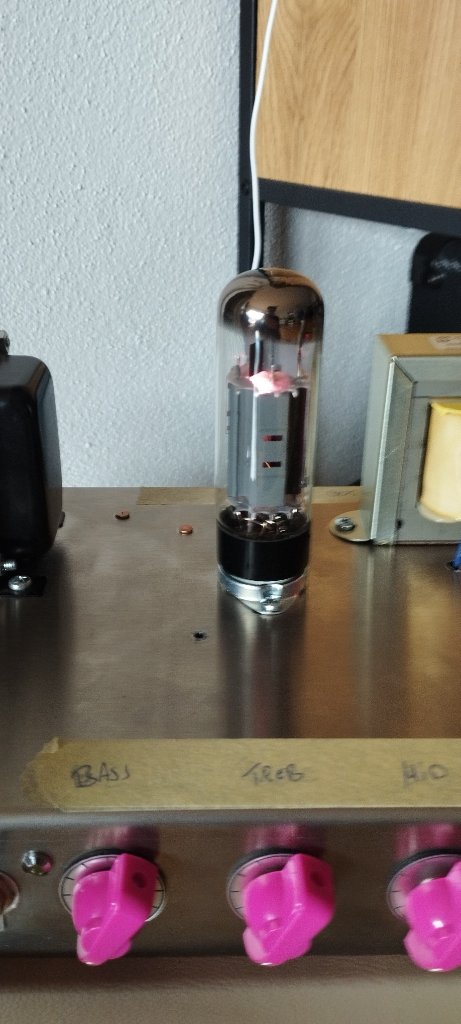

Good Today,
I finished rebuild my amp. When i turn the pre Amp on, i have something like this. When i turn power Amp, everything is quite normal, but in speaker is no sound.
Maybe el34 is broken down?

The colour of this light is rose.
- Dr. Nonosse
- Messages : 269
Re: Problem with my G5 amp
This is an inter-electrode ignition: The vacuum if bad. You will have to change the EL34 tube.

I must say, my el34 died.
I will order a new one and then everything must work. Thank you Guys very much

Thank you Guys very much. I think, all the time the el34 was broken down. When i rebuild my amp, probably i made everything good, but the power tube was dead.
I haven't meet so helpfull people. Thank you.

Good Today, i ordered a new El34. Still the same. When i turn on pre Amp, power tube Has a light blue colour. When i turn on the power Amp, no signal and power tube Has normal colour without blue. Maybe its output tranformator?
